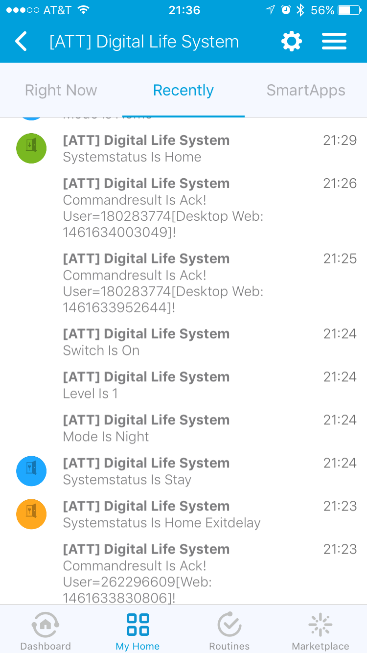

The connection is working pretty well overall. However, every couple of hrs the Smartthings DLS sends an armed notification ant then a disarmed notification… The actual Digital Life system does not arm/disarm in these instances… Any idea why this is happening?
Do you have SHM configured? Mine did that also. I had to disable SHM because it was freaking out.
I have the exact same problem, am still trying to figure out if it’s really AT&T or SHM. This started a few days ago, at the same time with AT&T Digital Life having connection issues - their website doesn’t work at this time, tried to get to the login page from three different locations. Getting random errors. I think AT&T is having some issues, sending messages down the pipe that are not really mine. I got an alarm pending from AT&T and also a bypassed device with an id that isn’t mine. That came down the persistent connection with AT&T. That device was not mine, they all have a unique ID (except for the digital life system that has AM00000004). Weird stuff with AT&T these past four-five days.

I just talked to AT&T. They expect more down time, 15min to 2 hours. Fun fact is that I was not able to arm my alarm through the phone or the web portal. Tried for two hours… I managed to arm it through the SmartThings instead LOL. Went to the Smart Apps, reconfigured the Home Cloud Hub app (went through Next Next Next). You’ll see the Next on the local server page won’t work - it’s because it times out logging in to AT&T - just be persistent. Then when it finally worked, went to the Digital Life System thing really fast and hit Away several times Managed to arm the alarm as I am not home. AT&T should communicate better when they have issues like this one…
