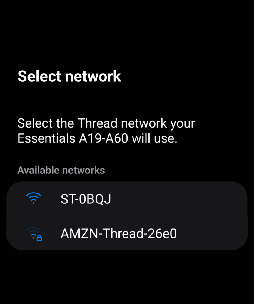

I tried to connect the lock as a matter device using ST and it needed a Thread network. I donât have one that I know of, but ST located some eero one and asked for the 32 but key, which I donât have. I think I need some thread network. Iâve seen them as low as $50 in Amazon. Not sure if I should convert to Thread and lose the WiFi control over the Kwikset app or just control it using Alexa controls.
If it is a Matter over Thread device, then it wonât work with your v2 hub since it only supports Matter over Wi-Fi. To get it into ST, youâll need some Thread capable hub such as the v3/Aeotec, ST Station, or an TV/Fridge with Thread support.
I donât know if you can manage the lock with both Wi-Fi and Matter over Thread or if you have to choose one vs the other.
You can use Thread devices with a v2 hub you just need a separate Thread Boarder Router. At home I use a 4th Gen Amazon Echo as my TBR. At camp I use a Tuya ZigBee Gateway (Matter Bridge) as my TBR.
How is that presented when commissioning a new device with a v2 hub? The OP said that he was offered a Thread network from a Eero device.
ST will ask you what hub to use if you have multiple hubs, then it asks what TBR to use if you have multiple TBRs and then it asks for a 32 digit key for the TBR you select.
In the case of Alexa if you start the process with Alexa you donât need the key.
My echo dot might be 4th gen, and it supports Matter, but I donât think itâs a TBR. I must be picking up my neighborâs eero TBR somehow. And since I retried Matter last evening, and then converted the lock back to WiFi when Matter didnât work, my Alexa routines now donât work and my custom command to open the lock with a pin doesnât work. ![]()
This is what happened. I used ST to start the Matter connection and it asked for a 21 digit key for the eero Thread network. I donât have an eero device. Are you saying that if I convert the lock to Matter and use Alexa to connect a matter device I wouldnât need the key? But does that just connect it to Alexa and not to ST? I probably should just get a new Echo and then Iâll have TBR and can connect to ST. I think I messed things up cause Alexa keeps showing that I can connect to the lock as matter even though itâs connected as WiFi and now my routines arenât working even though I had them working yesterday. Sigh.
Echo Dots do NOT have a TBR.
