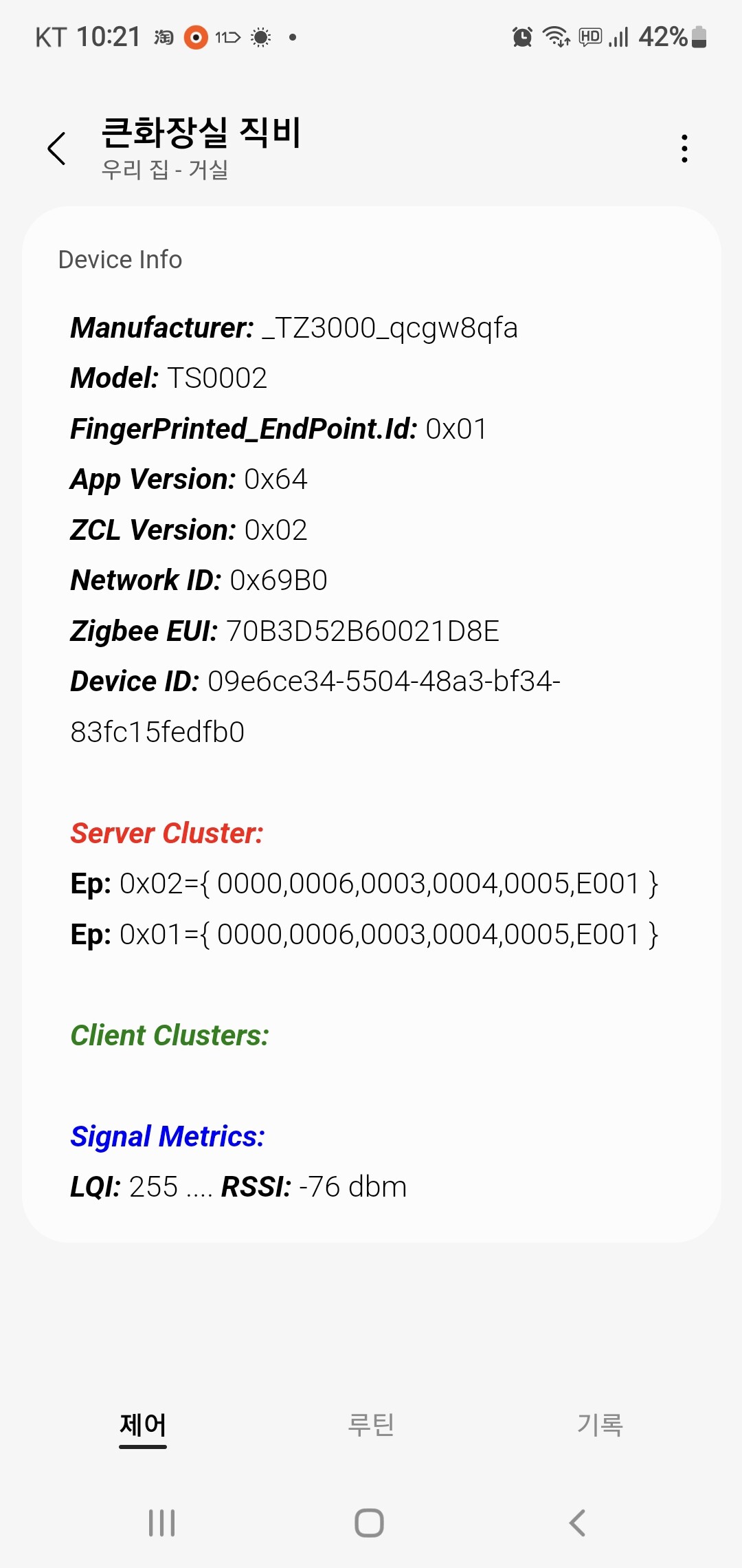

I'm looking for a TZ3000_QCGW8QFA SmartSings driver
I have a TUYA relay.
(brand : Zemismart, model : ZW-EU-02)
It automatically works in SmartSings, but there are two switch ports, but only one is visible.
So I’m looking for a smart synth driver.
Please check the captured version for fingerprints from Zigbee thing mc.
  • Manufacturer : TZ3000_QCGW8QFA
  • Model : TS0002

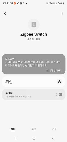

Sorry i`m new in this world, i have the same problem, so, what am i suposed to do with your info?
Go to his driver channel invite here, enroll your hub in the channel, and install the β€œZigbee Multi Switch and Child Mc” driver to your hub. You will then be able to add your device.
