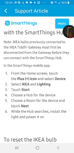

Hello newbie here, I did read thru the thread and unfortunately still have not been able to get my Ikea Tradfri Wrireless driver to be recognized by the smartthings hub. I do have the button controller which pares fine with the hub but the hub just does not find the wireless driver for the LED strips. I would really appreciate it if any has a step by step on how to get this to work cause at the moment im forced to also use the Ikea Tradfri hub just for the 2 led strips i have. I also have the Ikea bulbs that paired just fine. Thanks in advance for any help!!
I’m having terrible luck getting my Tradfri bulbs to connect to the smart things hub.
I have the bulb 2" from the hub, search for it, and nothing happens.
