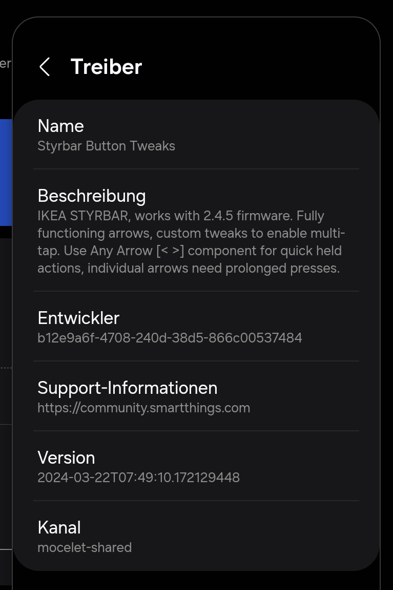

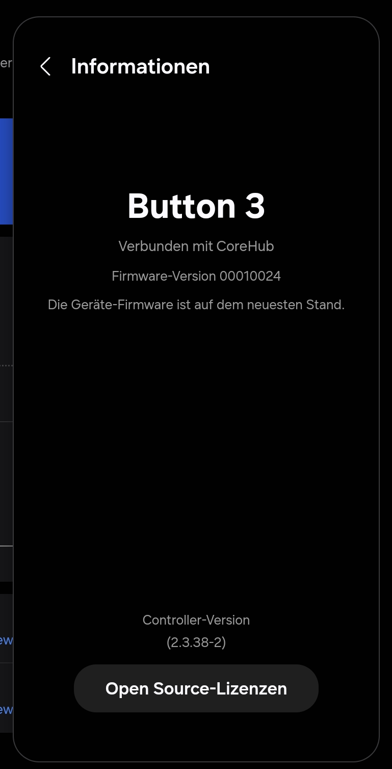

You could show us these screenshots and a picture of the backside of the button.
On the backside of my button it says TYPE: E2002
Thanks guys!
I installed the old drivers first in that post…
[Edge] IKEA STYRBAR Button Edge Driver (FW 2.4.5 compatible, full arrow support) - Devices & Integrations - SmartThings Community
So you where right
https://bestow-regional.api.smartthings.com/invite/Kr2zNDg0Wr2A
Styrbar Button Tweaks
This one looks more promissing. See buttons hit in history.
Thanks again
Edited the link
I’ve edited the post so it’s more speed-reading friendly and reduced the text to arrive to the actual driver. I’m sure you’re not the first that were misled and installed the non-working ones. Thanks for the feedback!
