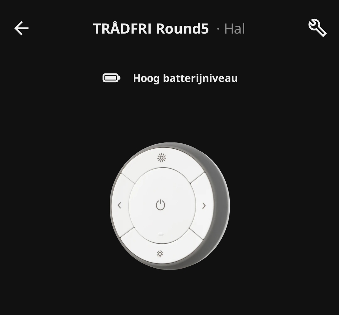

I also bought a Dirigera for that purpose. Non of my buttons need an update according Dirigera.
Go to the button in the Ikea Smarthome app. Goto one of your Ikea buttons, press on the tool symbol in the upper right corner. Then choose About and you will see the firmware version and if an update is needed.
Says nothing about latest firmware.
Grtn Ben
Let it stay, it updates the button automatically and it takes long.
Now it says Firmware xxx Up-to-date
