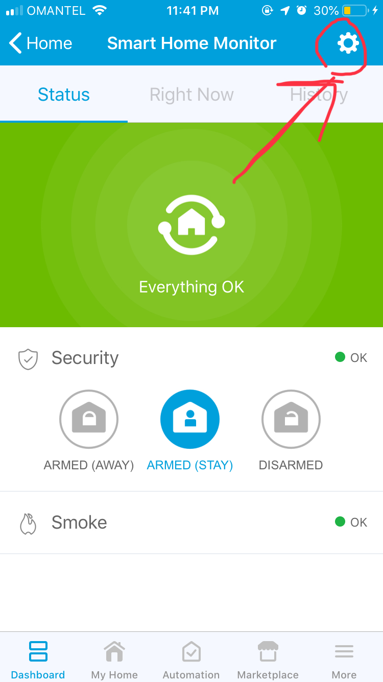

For that, I tried to use other way by doing the following:
  1. In ST App :: I create Virtual Switch, and I named " CALL ME "
  2. In IFTTT App :: I used " VoIP Call "
    ==>> " If CALL ME switched ON, then Call my device"
  3. In ST App :: In “Smart Home Monitor” ==>> “Configure " ==>> “Smoke” ==>> “Alert with Light” ==>> " Select Lights " ==>> Choose our Virtual Switch " CALL ME” ==>> SAVE
By this way, When “First Alarm Smoke Detector” detect SMOKE OR CO will switch ON our Vertual Switch called “CALL ME”, Then that switch will call my device by using VoIP Call via IFTTT.
