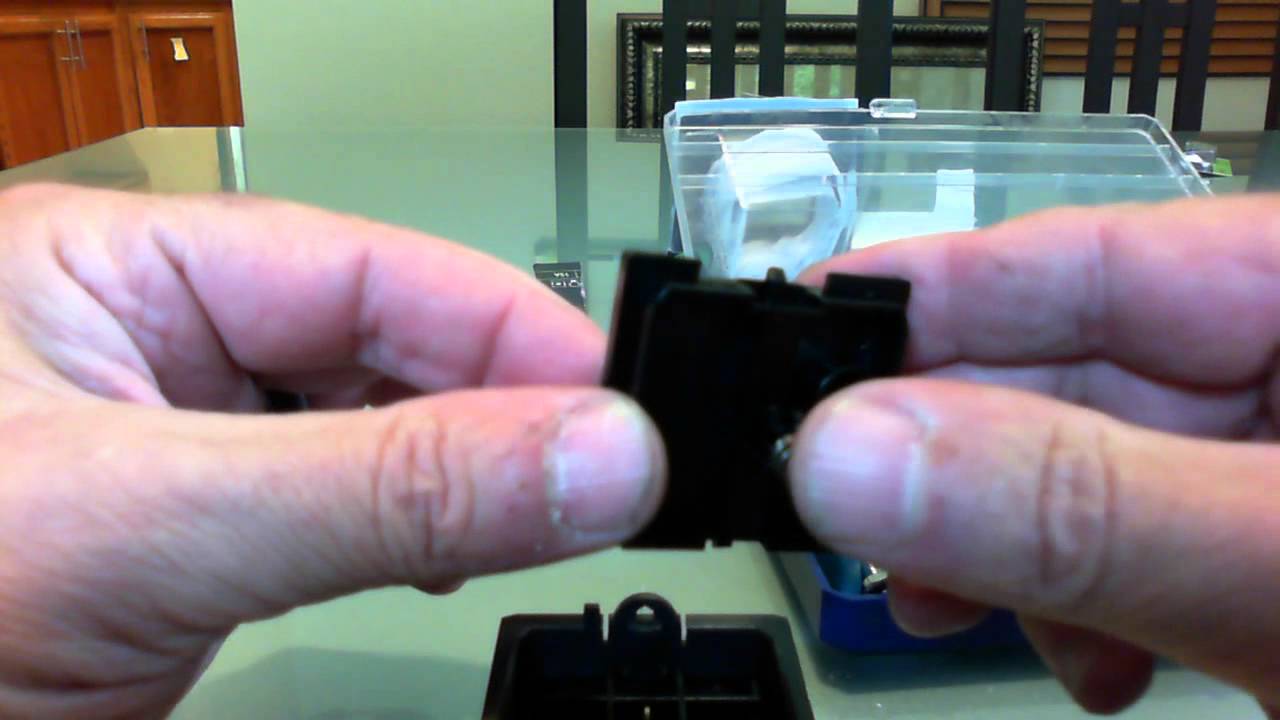

I did this to get over that out of sync problem
