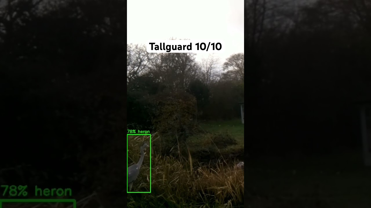

Hi,
I’ve been working on a project to deter heron and has been quite successful.
I’ve add to add a horn speaker and works well!
