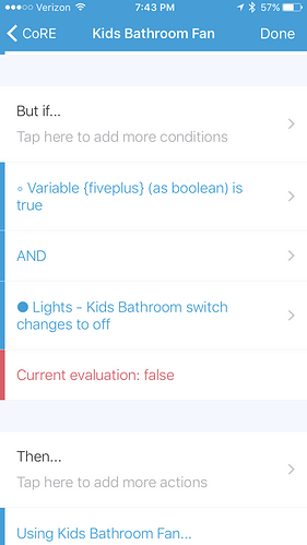

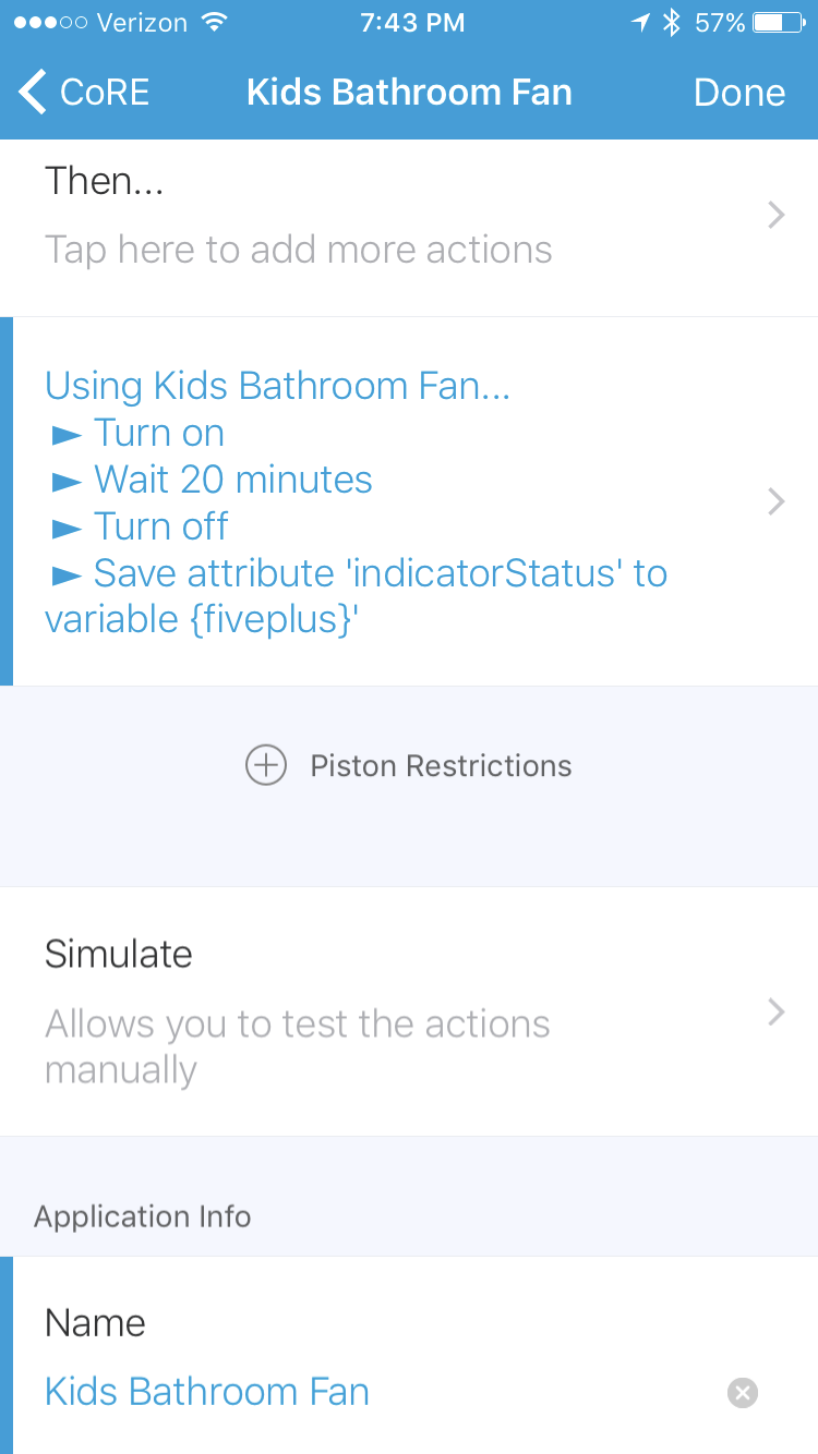

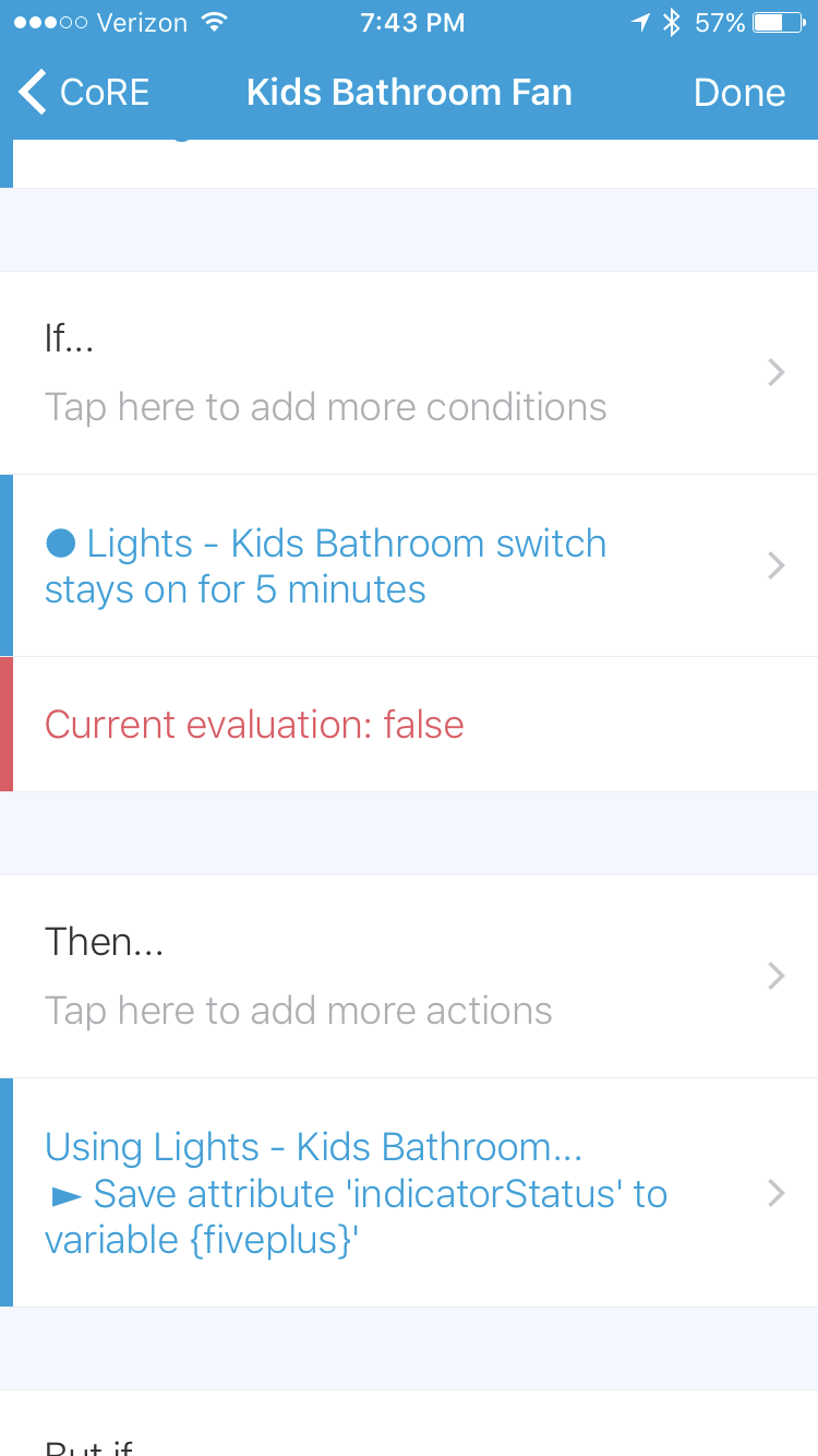

I went Keep It Simple Stupid and set up a rule in Core that says if the light in the bathroom Is on for more than 5 minutes then the fan will run for 20 minutes. If they are in there that long either it’s steamed up or something smells.
