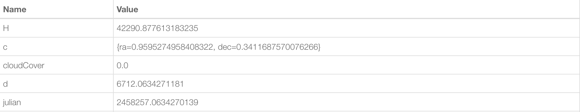

Might be that checking for sun was earlier then windchecking, could you paste application state? go to my locations, smartapp, click smart screens and locate state.
some additional info: i seem to only be getting the null when i configure a shade orientation as SE or E facing (12:00 pm local time). hope this helps.
which weather provider are you using?
could you also paste the settings?
did you provide the maximum windspeed that is allowed for your shade, below this speed the commands will be executed, when above action is take to protect your shade against windforce…
it is below Sun Protection Only Below Windforce…
that did the trick. i overlooked this since the screens i am commanding are interior and it wasn’t called out as a required field. many thanks for all of your help and working through this for me! ill reach back out to you in a few days when I’ve had some time to play :grinning: thanks again!
