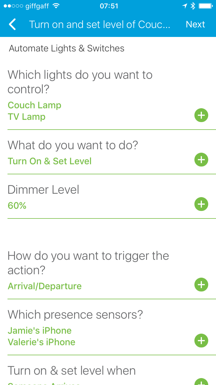

The limitations I’ve found so far is that I haven’t worked out how to set the Hues lights to a level, only on or off. I assume this will be the same for the Sonos,as it’s only seen as a switch within Smart Lighting.
Thanks Andy! Regarding the lighting level, that’s definitely possible in Smart Lighting (you can set colour too!). It’s a guess, but ‘dimmer level’ may also apply to speaker volume…
I tried this the other night but it fails to then turn on the light let alone set the level. I don’t think ST sees the Hues bulb as a dimmer?
