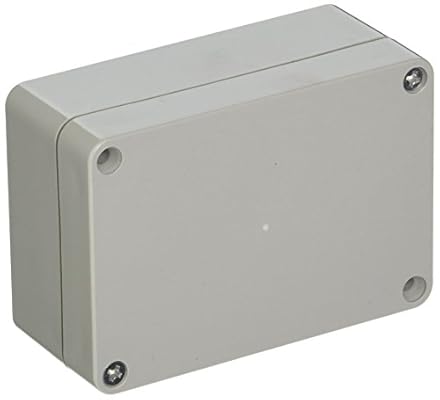

Still not a good idea. See earlier posts in this thread. Batteries can and do outgas. Battery-operated Devices should not be placed in anything airtight unless specifically designed for that purpose.
Instead, use a vented project box with the vents on the bottom so rain doesnât get in it. Any electrical supply house, or Amazon, will have these. ![]()
