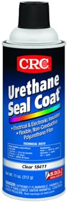

I cover up the sensor and battery terminals and spray the circuit board with this spray on my ST motion sensor for my backyard. After over a year outside. It’s still in perfect condition except a little discolouration on the outside because of the UV. It’s an older model sensor and I use usb power on the so not sure how long the battery would last. Picking up a bunch of PeQ motions in a couple of days and will probably do the same thing except with battery.
Well I picked up the box which was slightly too small but would still work, but before I tried a bigger box I tested it. It does not work at all thru the plastic no matter how clear.
So I am going to try @Navat604’s idea. Either of you know if I can pickup this spray locally anywhere (Home Depot, Lowes etc…)? I tried searching but could not find anything, maybe a different brand or something.

Go for an electronics sealant if you prefer. (Remember what you want is a “sealant” specifically made for circuit boards and other electronics. Not a “lubricant” made for motors that have moving metal parts.)
You won’t usually find those at home depot. Find a local electronics supply house (the kind that sells to electricians) OR a hobbyist shop for makers OR a hobbyist shop for remote control aircraft.
These are often very small storefronts but have 20,000 small parts in stock. Fun!
