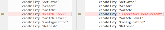

Hi, All:
I have two DTHs with capabilities as below:
I want to merge the two DTHs, but I do not know how to deal with different capabilities. Can someone tell me how to do ? Thanks!

Hi,@chenjun.
The Metadata defined for the Device in the DTH cannot be dynamic. This means the capabilities, Device type, and presentation.
A DTH can be shared by different devices only if they have the same metadata.
Or, unless you don’t mind having an empty capability, in this case, Temperature Measurement
, you can add it and create a custom presentation to display it at the bottom of the Device UI.
@nayelyz :
Thanks!I see.
