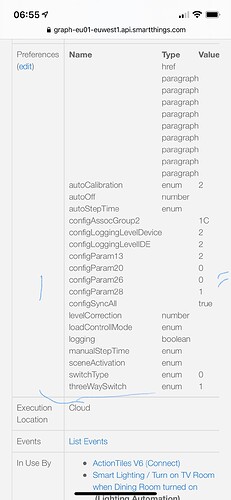

There does appear to be something weird with the setting of parameters. When I read the settings in the IDE for Family Bathroom I get two different readings for the same parameter.
Parameter 26 says 0, whereas the read back of 3-way switch at the bottom says 1. I have a gut feeling this has something to do with the fact that the Fibaro Dimmer 2 seems to be default joining to the SmartThings Hub as a Roller Shutter, which probably defaults to a Roller Blind type switch? Anyway both screenshots below. How do I completely erase parameter settings and start from a blank sheet… so I need to avoid it defaulting then driver when it first joins… can I force what driver it will use on joining?
David.
Don’t read too much into what you see in the preferences section in the IDE. Those are the values that you entered into the settings screen of the app, but may not represent what the device is actually set to. Same with the leftover preference variables from the initial pairing - it’s messy but it’s not a problem.
