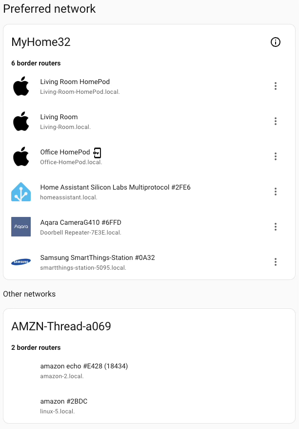

I was able to combine my ST Station thread network with my Apple Home one after removing any Thread devices connected to it. I don’t know exactly how or why it worked, but the utility in the SmartThings app worked first try. I do run Home Assistant as my primary smart home platform, so maybe something there helped.

How did you do that? There are no Thread devices attached to my Eero, my ST Family Hub, or my Echo Show Thread networks and yet none of those show up in the “Manage Thread Network” in the mobile app for my ST Station. And, as far as I can tell, there is no provision for Eero devices to do anything other than have their own Thread network. I also can’t find anything that says how you can make an Echo device join another Thread network.
That’s interesting. When I first messed around with hub groups I am sure that is how it worked for me, and it was the reason I stuck with hub groups for far longer than I wanted to (I didn’t want the hub group, but I did want all the hubs on the same thread network). Then when the last firmware update came along I removed the hubs from the group and found they had kept the same thread network.
I should note that all my secondary hubs would have spent some time acting as the primary hub in the intervening period.
I don’t know, I guess Aqara are following the specs properly.
Yup. Same experience I had with Aqara and my Apple Home thread network.
