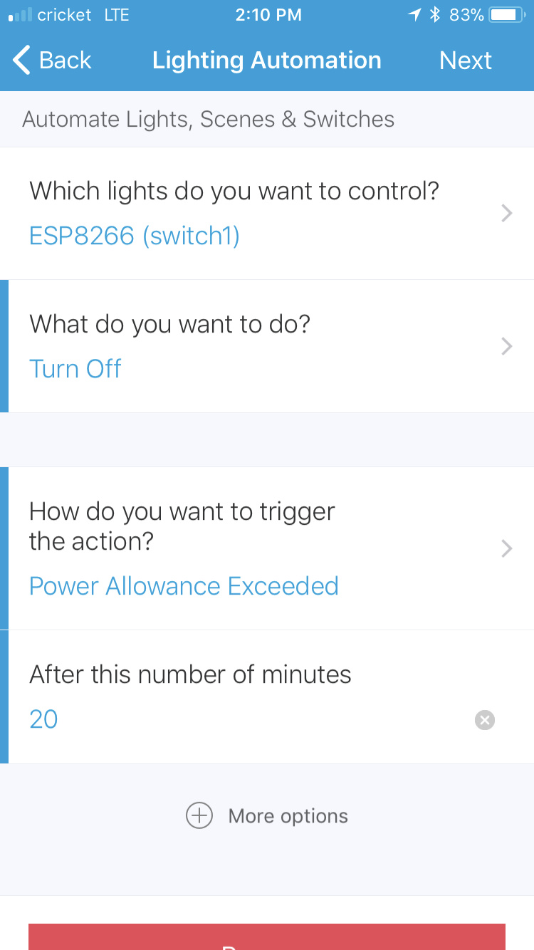

That’s an easy one using the built in Smart Lighting app.
Just configure a new Smart Lighting Automation as show below:

I have 3 automations that look just like this. No luck. What is the trigger? Turning on the switch?
Yes, turning on the switch should do it. However, you mention you have a WiFi switch with a custom Virtual switch. When you trip the WiFi switch manually (via physical button on the device, or using the Smart Life application), does your virtual switch in SmartThings change state automatically? If not, there’s your problem.

As others have said, you just use the “power allowance” Option in the official smartlighting feature to have your virtual switch turn itself off after 20 minutes.
Since you already have the IFTTT applet set up, Every time the virtual switch turns off, the physical switch will turn off as well.
The timing won’t be perfect as IFTTT could introduce a little lag, But for your purposes it should be good enough.

Thank you all. Got it to work. Thanks. Just did not give it enough time to activate.
