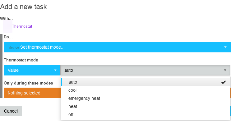

By operating state do you mean the thermostat mode? If so, no it’s still there. Here is what is exposed to webCore:
In May 2018 you posted this screenshot, how do I get to this page where I can compare operating state?
Is this on android?
Not on Android, that is a desktop web browser webCore screenshot.
So in the screen shot you posted, that is for the trigger/condition section in webCore, not the task section. What I posted a couple posts ago were the exposed things in the Task section. So if you want to trigger on the thermostat’s operating state, select your thermostat in the IF section and you’ll see the operating state.
Awesome! I appreciate the help Bryan.
