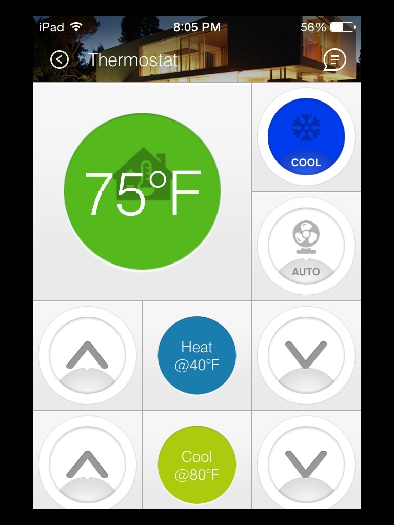

I have made some modifications to to the code, still working on the humidity setting. Fan mode works and I made some changes to the way heat and cool are displayed.
@jodyalbritton
Sweet!
I like the Heat and Cool labels, seems like the fan is working better, I better quit turning it on and off or I will break my AC? :frowning:
