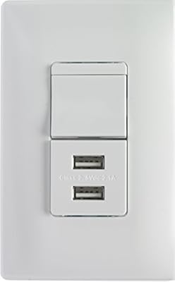

BTW, Pass & Seymour (LeGrand) make a line of light switches and outlets with built-in USB chargers which can be a very simple approach for a wall mount tablet:

I’ve seen those light switches before with the built in USB, but only issue is I’d really like it to look clean without wires. I am not sure about POE/CAT5 because it just seems like a lot of extra work as those wires need power too.
Ideally I’d just like to hang this over my light switch with a hole drilled in and drop the wire into the light switch and wire it with power from there. Possibly using a QI pad behind to charge it, vs. drill power in?

If you get the switch that has the USB slot built-in, then you can put the tablet over the top of that. Assuming your code allows it, and most do, you can inset the switch slightly so that the tablet will be flat on the wall or you can put a frame mount around the switch.
