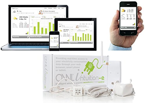

I bought the Owl Intuition 3-phase monitor …£110 …they do single and 3-phase.
Installation was very simple…just clip the induction clamps (need to be careful you get the right diameter for your cables/max current load) round the cables in the supply panel.
You can monitor via the phone app and a Web panel that lets you generate detailed csv files for further analysis in a spreadsheet but my main usage has just been to spot high consumption peaks and generally cut out waste…I think it paid for itself in a few months!
