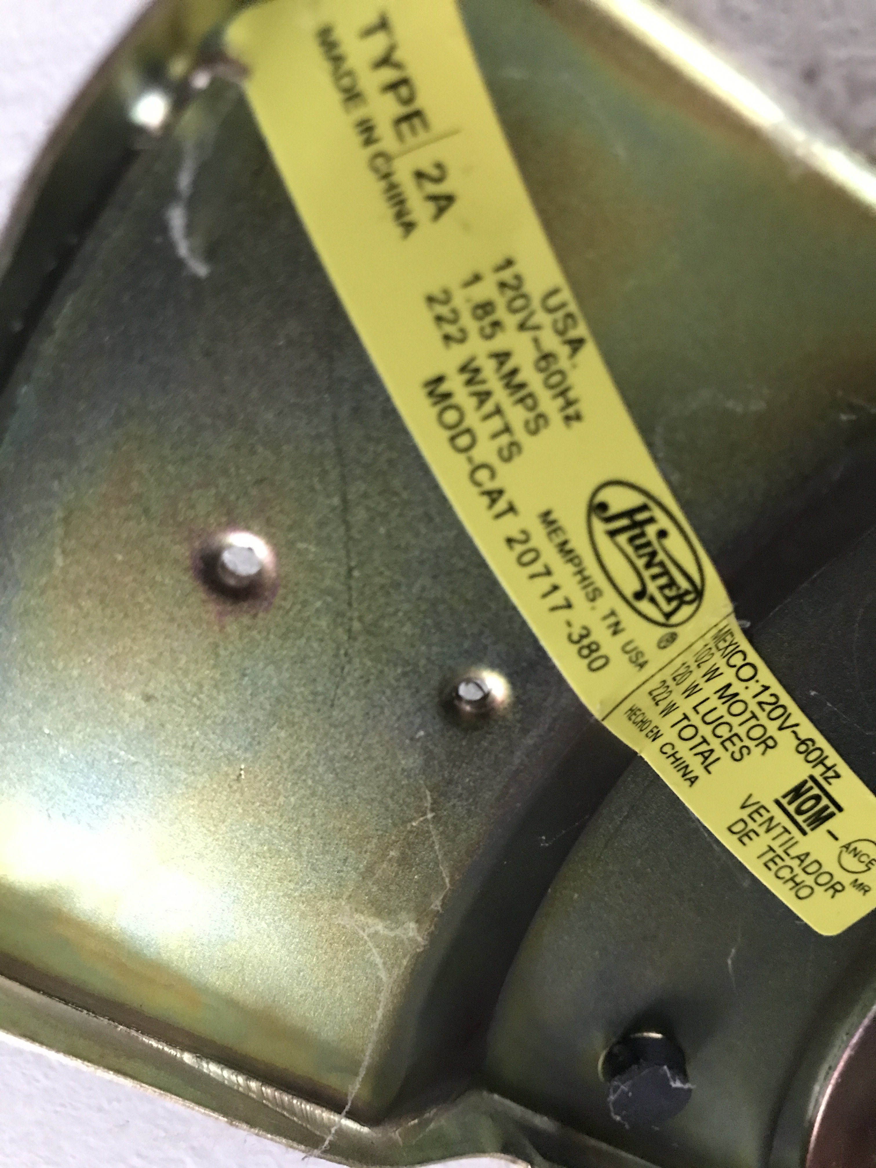

I’m 0/2 now. Dug into my family room fan only to find this…
Has nobody else run into this problem of being over the amperage?
The sticker says the motor is 102W and the lights 120W (2x60 or 3x40?).
If you use LED bulbs you should stay under 1.25A.
I think you maybe looking at the specifications incorrectly which is easy to do. :wink:
Zigbee Device Specified Maximum Ratings
MAX. motor amps: 1.25Amps
MAX. light watts: 190Watts (Incandescent or electronic ballast)
To determine power in watts use:
Power = Voltage * Current
150W = 120V x 1.25A
Your Hunter fan motor is 102W and below the Zigbee device max motor rating of 150W.
Your Hunter fan lighting max is 120W and below the Zigbee device max light rating of 190W.
You are not over amperage and are good to go.
