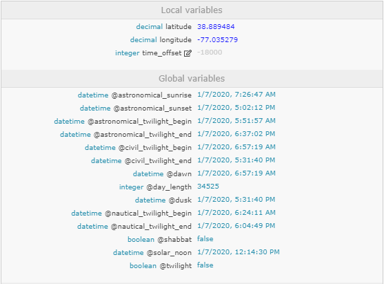

Just getting started with WebCore and am hoping to write an automation that pulls the sun culmination data from suncalc.org (Or any other service, for that matter) for zip code 23510 and set a virtual switch to turn off 15 minutes after that. Any ideas on how to get started with this? Was hoping to close blinds after the sun has started to directly shine into my window.
This thread at the webCoRE forums might be a good starting point. It’s got logic that scrapes a REST API and stores it in global webCoRE variables for pistons to take action on.
