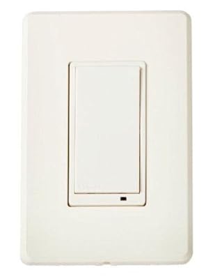

I have recently moved and the bedroom I now live in only has one switch for the ceiling fan with lights. I have a GE Zwave dimmer switch for both the lights and the fan. The problem is I cant just buy a new fan and run a wire to add the other switch because there is no access to the attic. I would like to be able to control the lights and the fan separately but outside of running a new wire across the roof of the room I don’t know what to do. Can anyone help me?

That is the link to the fan controller I have.
