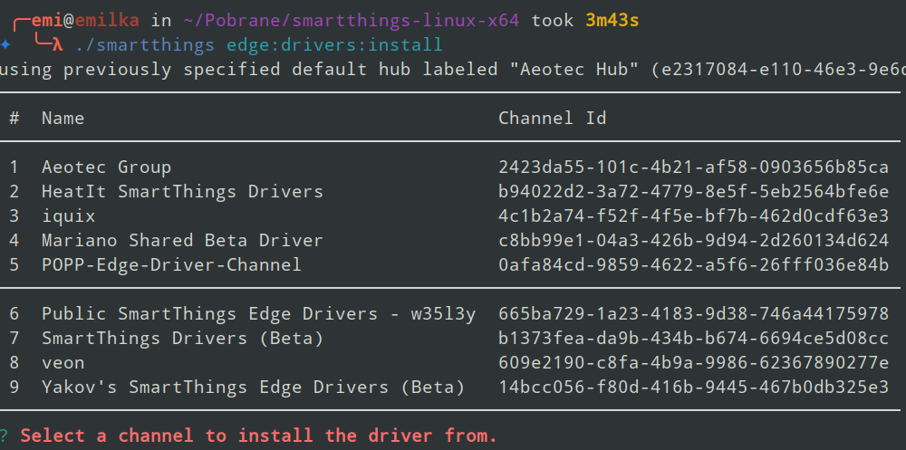

 Name         Zigbee Siren Mc
 Version      2024-02-28T16:39:13.171032541
After driver installation you can check drivers versions using CLI command
smartthings edge:drivers:installed
OK, I have that one:
Zigbee Siren Mc 324f189f-f73b-4493-98e3-170fdd621b44 2024-02-28T16:39:13.171032541
Looks like working OK now :smiley: Thank You very much.
