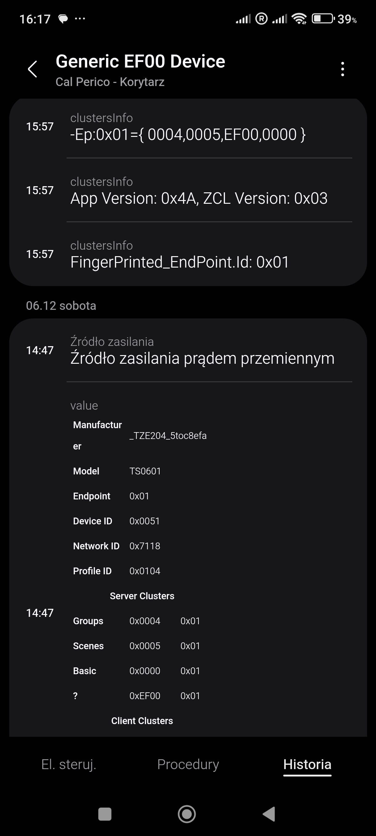

Can you share the information about the clusters provided by the driver “Zigbee Thing MC”? I believe that’s where Mariano (the developer) exposes this information. In your screenshot, we can only see the “server clusters” at the bottom. Knowing which clusters are supported by this device can help us identify which driver can help.

Thanks for your reply. I’ve included all the information provided by “Zigbee things MC” below. I have all the Mariano drivers and any others I could find installed on the hub, but in the “change driver” section, I only see the ones I listed. I couldn’t find many mentions of “TS0601+_TZE204_5toc8efa” online, and I assume that’s the cause. Thanks in advance for any help.

I’ve been researching this Tuya device since it uses a manufacturer-specific cluster, which is 0xEF00.
The above means that it needs a custom driver to work since it isn’t certified, and the unofficial driver that is part of the SmartThings repository doesn’t include this fingerprint either: SmartThingsEdgeDrivers/drivers/Unofficial/tuya-zigbee at main · SmartThingsCommunity/SmartThingsEdgeDrivers · GitHub
I saw in the post of the “Personal Tuya Devices” driver that you need to select the corresponding profile for it to work. Did you try the one for the thermostat?
Additionally, since there is limited information available about this specific device, I am unsure which states/commands it should accept, such as “on”/“off” or “open/close”, as this cluster appears to be generic.
