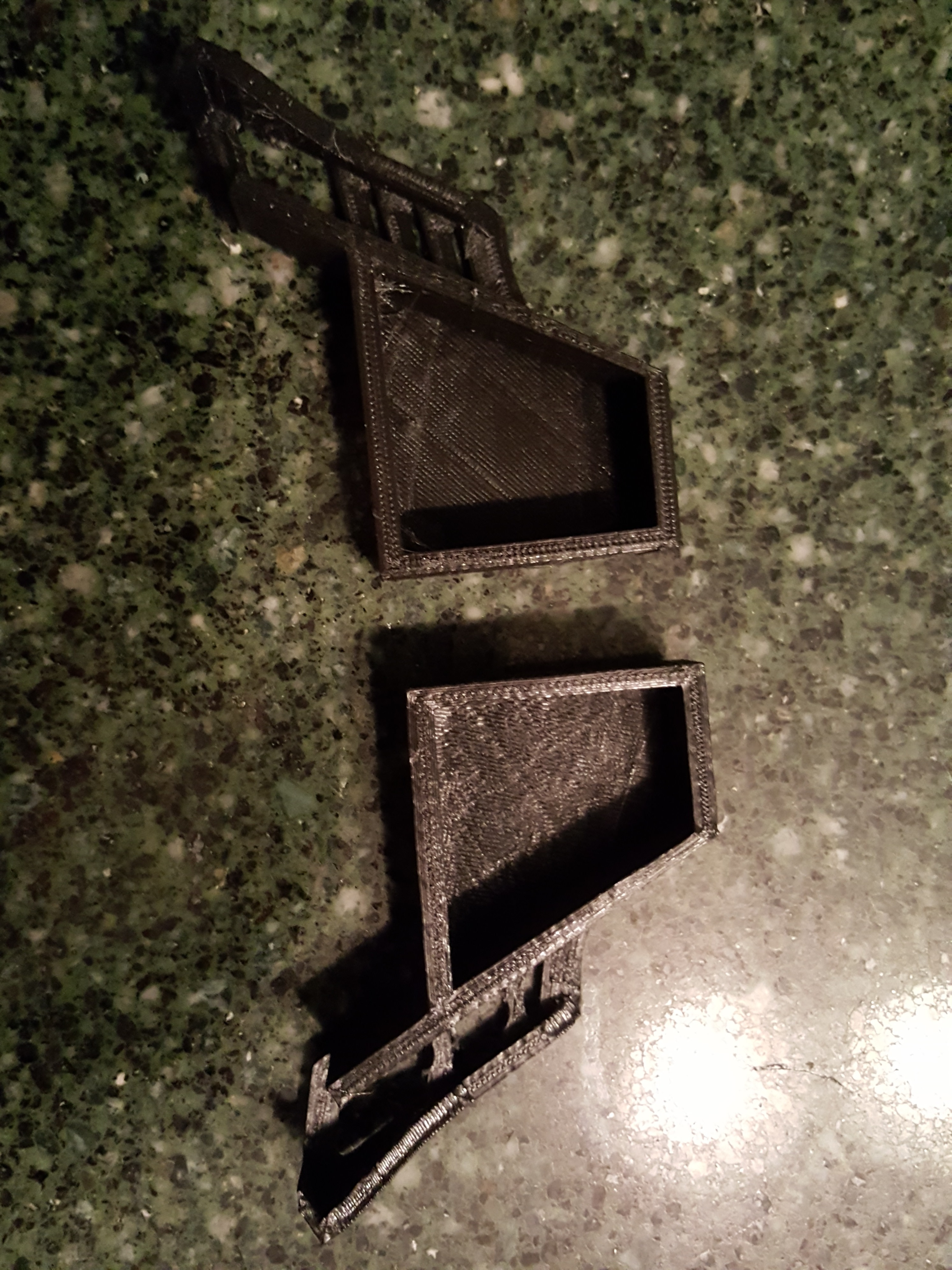

Thanks for the encouragement! Is there anyone out there with a 7" Fire tablet and a 3D printer that would like to test the fit of my brackets? My tablet won’t be here until the 30th. I can forward the STL file if interested. Thanks!
Mission (mostly) Accomplished! Th tablet arrived early, so I was able to test out the brackets and tweak them a bit. Now that I know everything fits, I’ll be reprinting the brackets at a higher quality, as the current set is very rough. They’re mounted with command strips, so they’re very easy to swap out. I also have some security cameras on the tablet, along with a Ring doorbell, so when someone rings the doorbell, a popup appears over the dashboard that takes you to live video. Thank you SO much to everyone who helped me out with this project. If anyone wants the STL file for the brackets I made, just let me know.

  1. If you’re mounting it flat on the wall, I still think @beckwith’s idea is awesome and super-clean. If you want to mount it at an angle, or don’t like the idea of wireless charging, then you can use just replace one of the light switches with a USB outlet, and put a blank over the other two. If you’re using a 2015 Fire tablet and have access to a 3D printer, I’d be happy to send you my bracket design files.

@OdinTheDog Hi any chance you share the stl file for this mount I have been looking for one to print. thanks
Just install the Ring app on the tablet, log in, and it should just work!
No problem, I’ve just uploaded it here! https://www.thingiverse.com/thing:2722101
Perfect thanks
I just realized that when I uploaded it, I accidentally put up 2 versions of the right-side mount. I’ve corrected it now, so the most recent version of both are up there.
