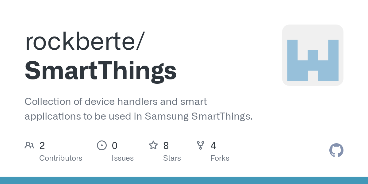

I bought the HEIMAN HS1CG Smart Combustible Gas Sensor for Z-Wave and tried to connect it to my SmartThings hub. I was able to connect it, but I couldn’t find a device handler that worked for me.
So after a bit of research I wrote my own one which you can find here:
https://github.com/rockberte/st-zwave-heiman-gas-sensor-hs1cg
It is as simple as possible:
Is just handles the NoficiationReport send from the sensor, while using the “Smoke Detector” capability.
It would be fine if anyone could take a look at it, or find ideas to extend it.
For me it works as needed -> it reports an alarm in case it detects gas, not more not less.

I extended the DTH to support “Health Check” because the device was always shown offline as it doesn’t send any reports or states. So I added the “Health Check” capability which reads the devices version every 8 hours. That keeps the device ONLINE in case it is reachable.
Please find the new version again here:
You need to switch the DTH for the device after updating the DTH to any other DTH. And then switch it back again.
Otherwise the DTH’s installed() method won’t be called. That methods sets the Health Check interval used by the Health Check timer. That is necessary to start the Health Check timer.
