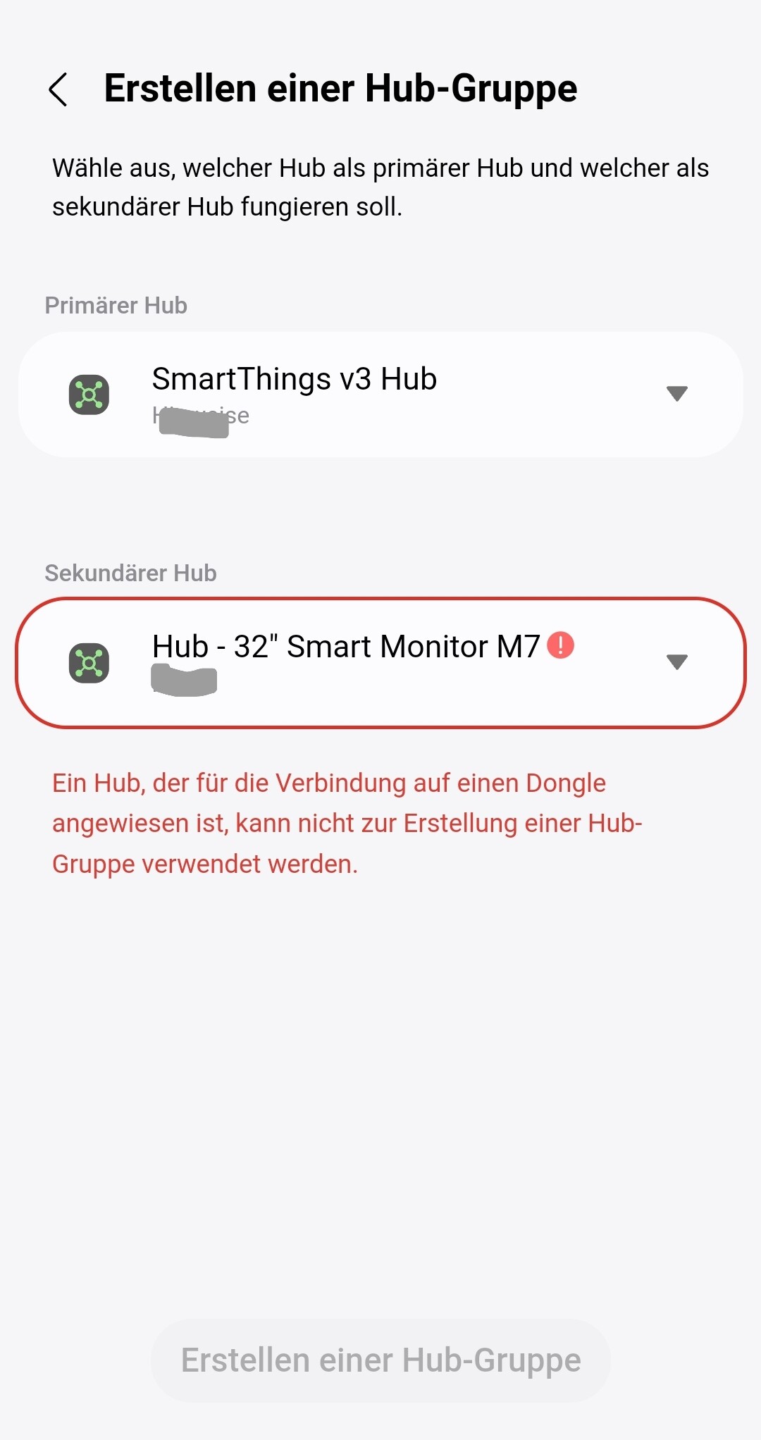

So I recently bought a new SmartMonitor M7, which has Hub functionality not via Dongle only. I was able to connect/use it as primary hub for some Sonos speakers AND an Aqara Hub E1 and its connected Matter (!) devices.
But it is still not accepted as Secondary Hub, although mentioned in the “supported devices” info the Smartthings Android App?!
Online, I cannot find any more information in the specification tables of all actual SmartMonitors, which one of them might have the so called “secondarySupportAvailability”

As far as I can see you have a Smart Monitor which can act as a standalone SmartThings hub over the LAN and you have been able to use it as such. It should support Matter over Wi-Fi devices, Matter Bridges and presumably also Matter over Thread devices if you have an external thread border router.
In order to add Zigbee and Thread support to your Monitor it appears that you need to add an external Dongle and it doesn’t look like you have one.
Without Zigbee and Thread support a hub cannot participate in a Hub Group. A hub that depends on a Dongle for Zigbee and Thread can also not participate in a Hub Group. A hub that already has devices connected cannot be added as a secondary hub to a Hub Group without first removing them.

I get that and I also tried to add M7 to my V3 without any connected devices on the M7.
What I really wonder is why they promote SmartMonitors as a possible Group Hub without giving them the needed functionality?!
