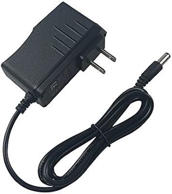

What Tablets? You could very easily purchase a 5V-Needed Amperage AC/DC Wall Converter and splice in the USB Cable.

So, it depends on how much power your tablets will be using. For simplicity, you could just build your own USB cables, with the cool end that I listed above, and use a multi-charging station such as this:
This way, each unit will have the proper amperage no matter the load.
If not, then a 5V-3A AC-DC Regulated Transformer such as this “should” work for all three in parallel:
