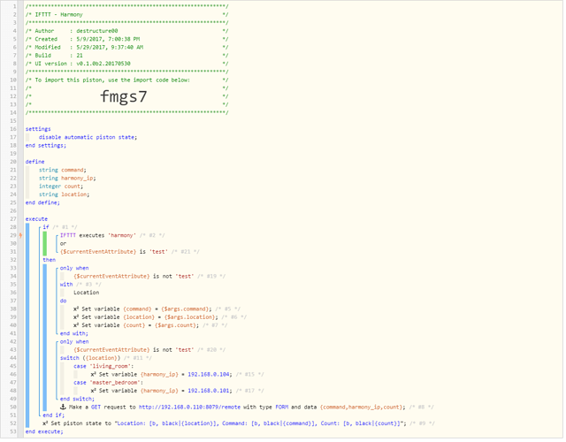

WebCoRE web requests are similar to CoRE, here’s one for voice commands to my Harmony hubs.
Ok cool, thank you! I’ll try and replicate my voice announcements in WebCoRE then, since there appears to be a bug in the Android UI for CoRE.
WebCoRE should be more user friendly, you can create your pistons via web interface instead of the limited ST app, and all of the actions execute sequentially so there’s no worry about setting variables during execution and that sort of thing.
