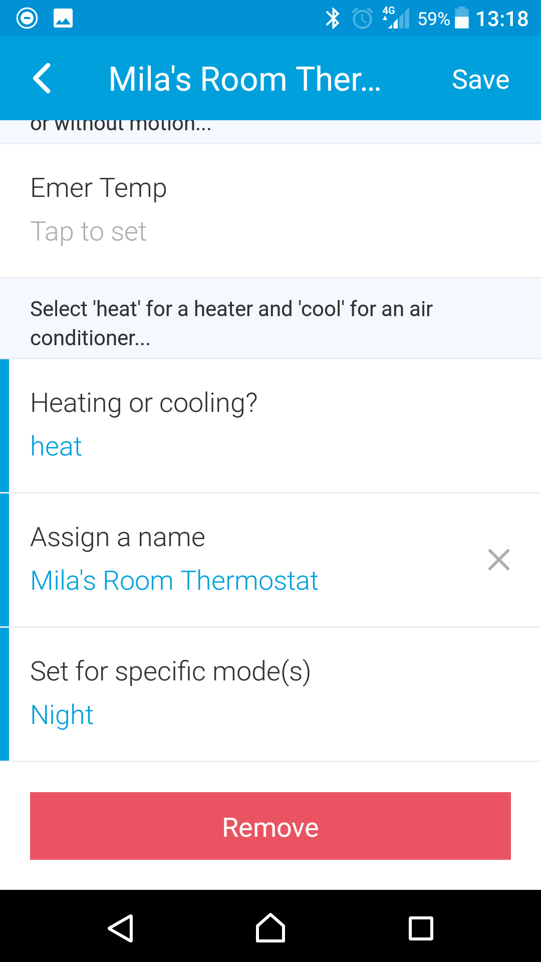

This is my virtual thermostat setttings:
So, I think this all works BUT only if someone comes home before 1730. Otherwise the mode doesn’t get set to “Night” and therefore the Virtual thermostat doesn’t activate.
