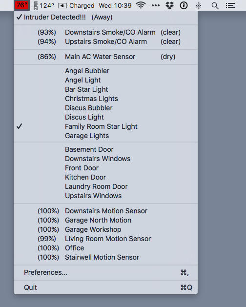

I’ve added a few more features as well… here it is armed but not triggered. The % readouts are batteries. Any lights that are on, or sensors that are tripped will get a check mark next to them. Tap a light to turn it on or off. Tapping anything else doesn’t do anything.
And here it is triggered. Normally one of the sensors would be showing as triggered at this point, but I use a virtual contact sensor to trigger the alarm when I’m not at home for testing, and I don’t have that sensor tied into the display.
