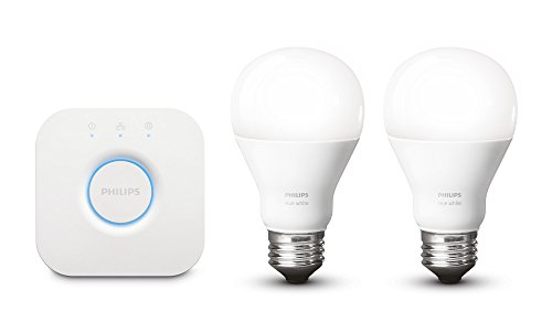

The plain white Phillips hue bulbs typically run around £15. You can get a starter kit with two of those and a bridge for £49.99 at the regular price, so you are only paying an extra £20 pounds for the bridge.
