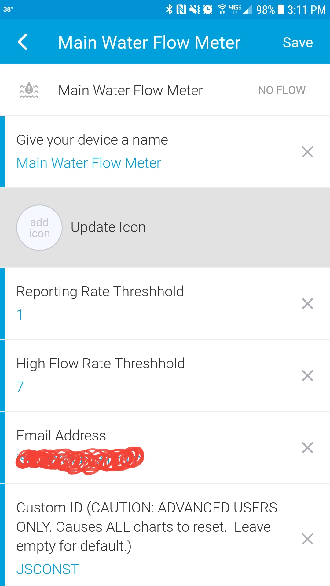

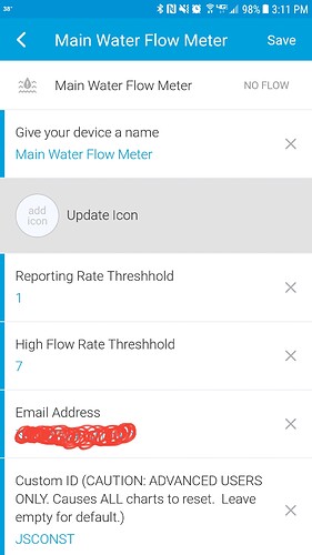

As soon as you switch over to my DTH, go to the app and go to Device Preferences. Here’s what you’ll see:
Reporting Rate Threshold is the time interval between meter reports while water is flowing. 6 = 60 seconds, 1 = 10 seconds. Options are 1, 2, 3, 4, 5, or 6. My DTH default is 1, FortrezZ’s default is 6.
High Flow Rate Threshold is exactly that. Default is 5.
Email Address is the same as before, and it should be there.
Custom ID can be left blank, BUT since you’re having chart display issues for a while now (not platform problem related), put something in there like “MAGDA”.
Tap on Save and you’re done. Go run some water and let’s see what happens.

Make sure to follow the directions I gave you in the other post about changing Device Preferences.

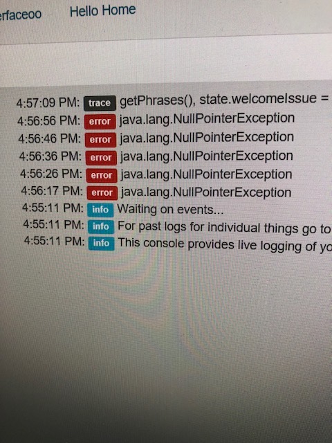

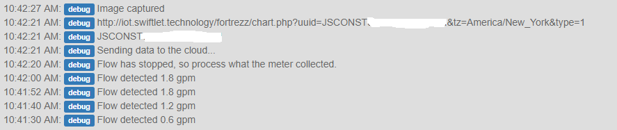

What does Live Logging (in the IDE) show for the water meter? I need to see that while water is flowing and after it stops.
Please go into the code and remove the “//” on line 329 to get flow messages to show up in Live Logging. Don’t forget to Save and Publish.
It should look something similar to this:

That live logging does not show anything for the meter. When you run water you will see the name of your device. Click on it and you will see events like mine. If you don’t, then rejoin the meter to ST.
