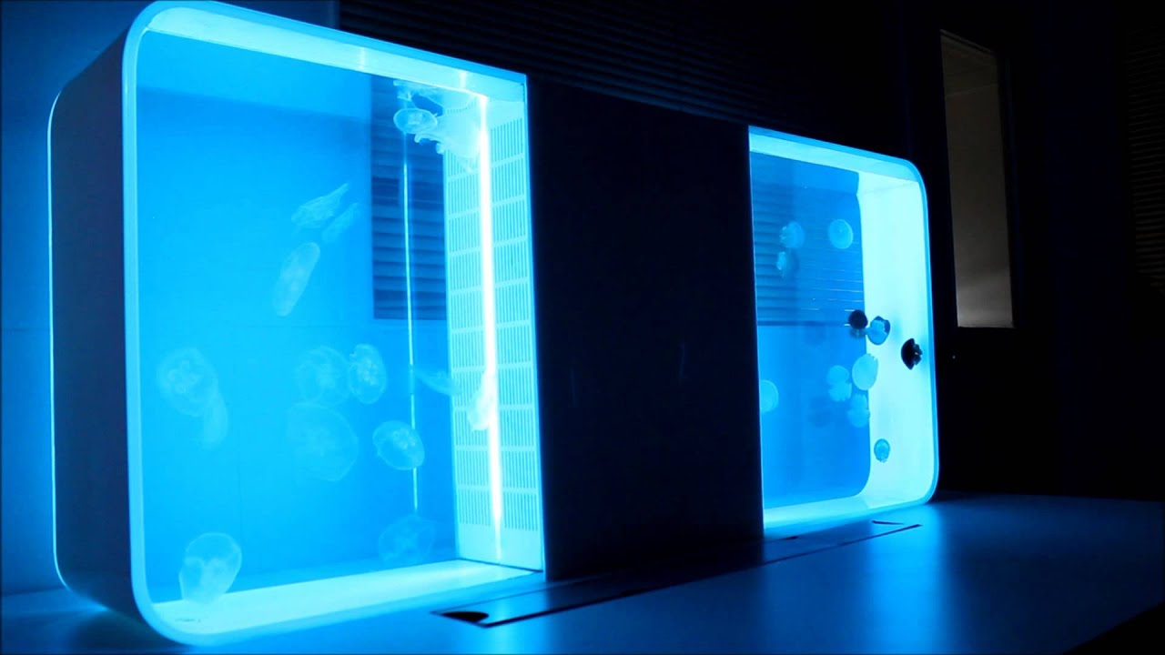

Excuse my eyes but what is that LED strip in? I can’t seem to make it out?
The FLS-PP lp is just connected to the standard LED STRIP that comes in a PULSE 80 CUBIC JELLYFISH AQUARIUM . . . as shown better here:
Oh sweet! That looks awesome!
will be better when this doesn’t keep freezing up haha :wink: cheers though
