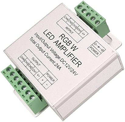

Wouldn’t it just be easier to link the 2 sets using an RGBW repeater instead of having 2 controllers?
