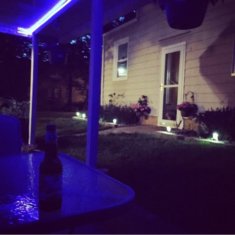

Any progress on getting the white control working with ST? I’ve finally got it working on my back porch.

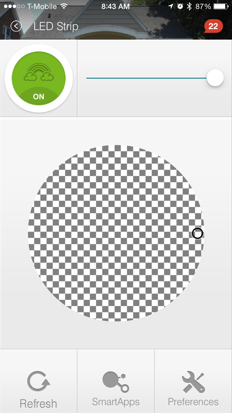

On a side-note, my color wheel disappears all the time…anyone else have this bug?
