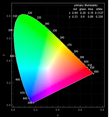

The white channel of a RGBW light strip is calculated automatically based on its selected color and brightness.
Two things are important here:
the color saturation
the brightness
Less saturation and more brightness = more white channel output.
The reason is that in ZigBee all colors are defined within the device independent CIE 1931 color model where no such thing as RGB(W) exists. All colors are defined through their x,y coordinates in the above diagram.
What about a single white slider?
It would have been possible to provide the white channel as a separated logical device (a single dimmable light like the hue Lux). This is allowed in the ZigBee standard, but in our tests we couldn’t find any gateways which supports this.
That’s the reason why we decided to go with the automatic calculation of the white channel for now. Once the gateways support compound devices the firmware could be updated via OTA.
