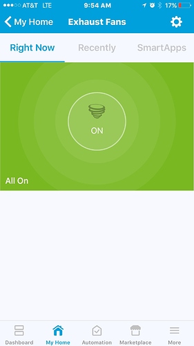

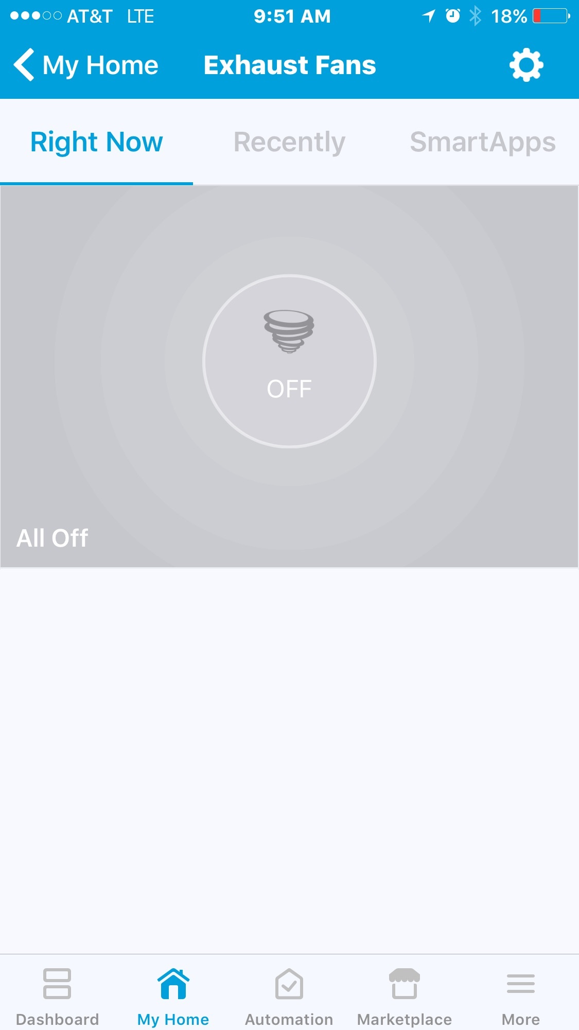

Trend Setter is the App for you. It creates the Virtual Switch and keeps it in sync with the Phyiscal Switches. You can use it as a Switch in CoRE as well.
If any of the switches are on at any percentage, Trend Setter will still allow you to sync the on/off function appropriately.
Awesome, I’ll give this a try thanks. So you’re saying these virtual devices will resond to an on/off command and activate pistons even if they are already in that respective state? Or do I need to use a virtual dimmer so that even if it’s “On”, it will still set level to 100% from a dimmed state? (and to 0% from and dimmed state)?

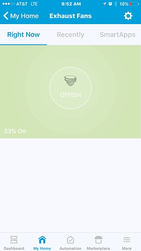

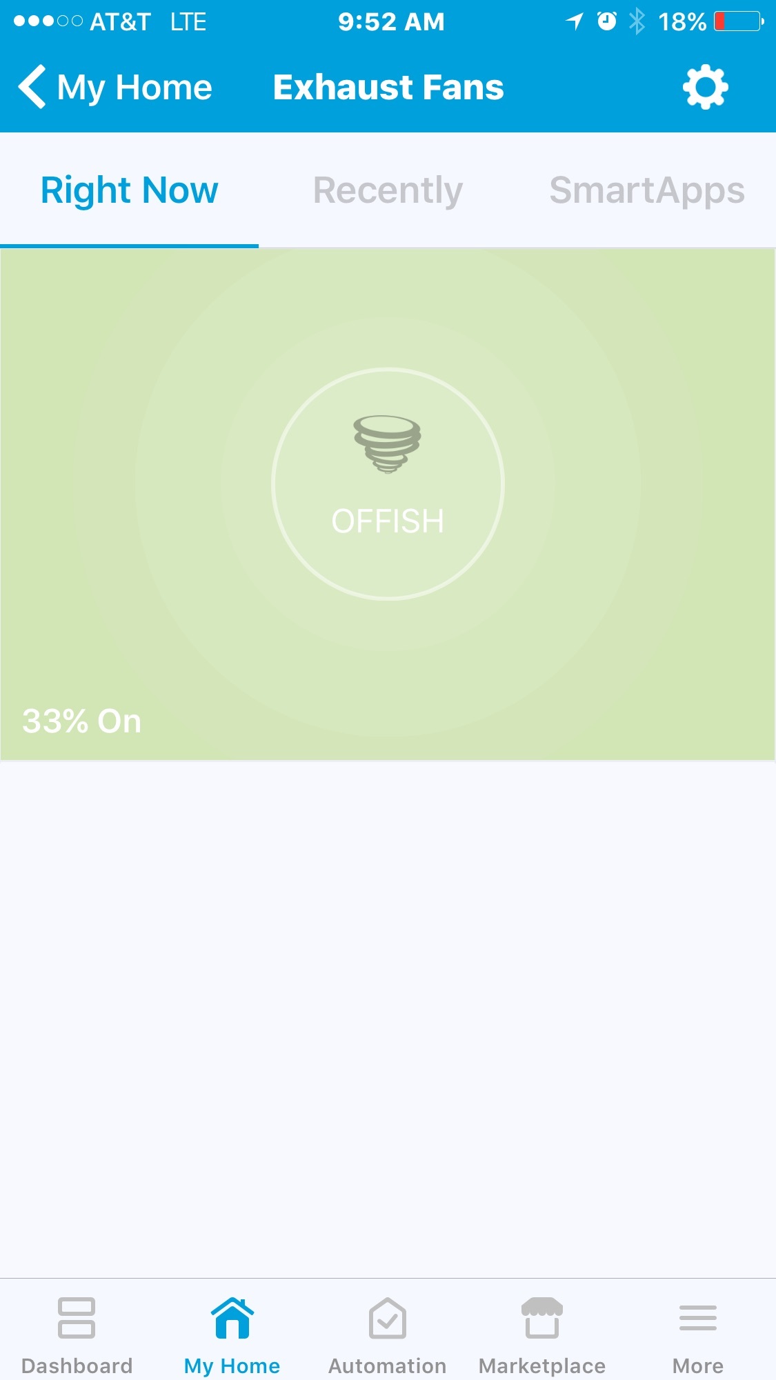

With Trend Setter, even if one switch is off, the Virtual Switch will be on. So, it says stuff like, “Mostly On”; “66.6% On”, “Half On”…
If I had 4 lights grouped in Trend Setter and I only had 1 light on, It would say “25%” on. So Cool. This way if you use the Virtual Switch and no matter what combination your lights are in, If you say turn Virtual Switch On, all lights come on. If you say turn Virtual Switch Off, then all light go Off.
Then using “CoRE” you set your rules for your differently lighting scenes or whatever App you have already been using.
