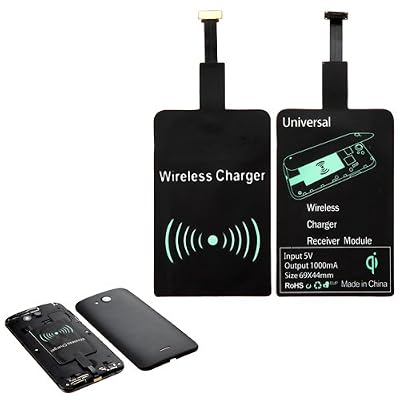

I have mine successfully charging using.
Wireless Charger,Itian™Qi Wireless Charging Single Coils
iDOO Ultra Slim Universal Qi Wireless Charging Receiver Module
Seems to be roll of the dice. I couldn’t get the iDOO to work.
I suspect it is the Fire tablet. I made a slit in the USB opening to slide the receiver under the cover:
It worked great. I then tried playing around with magnets and landscape orientation. Now it does not charge. The blue light on the transmitter lights but I get no “ding” confirmation.
I put the cover on a different Fire tablet and it works fine.
Makes no sense. I can charge with a USB cable so it isn’t the connection.
