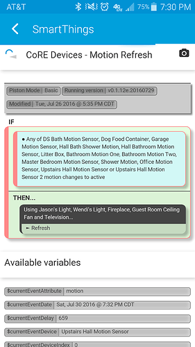

This is how I get around that lag… But I have a bunch of motion sensors in my house.
Every time a motion sensor goes active my devices refresh.

When refresh is run on a device it’s just the same as tapping the refresh button in the app. The device status is updated. It is very rare that my physical press on my switches takes longer than a second. Usually it’s almost instant because if the refresh piston.
This allows my switches to still run local since I don’t have to use custom code to try and make it report faster.
I would expect that this would only help if the motion sensor went active just after the switch was turned on.

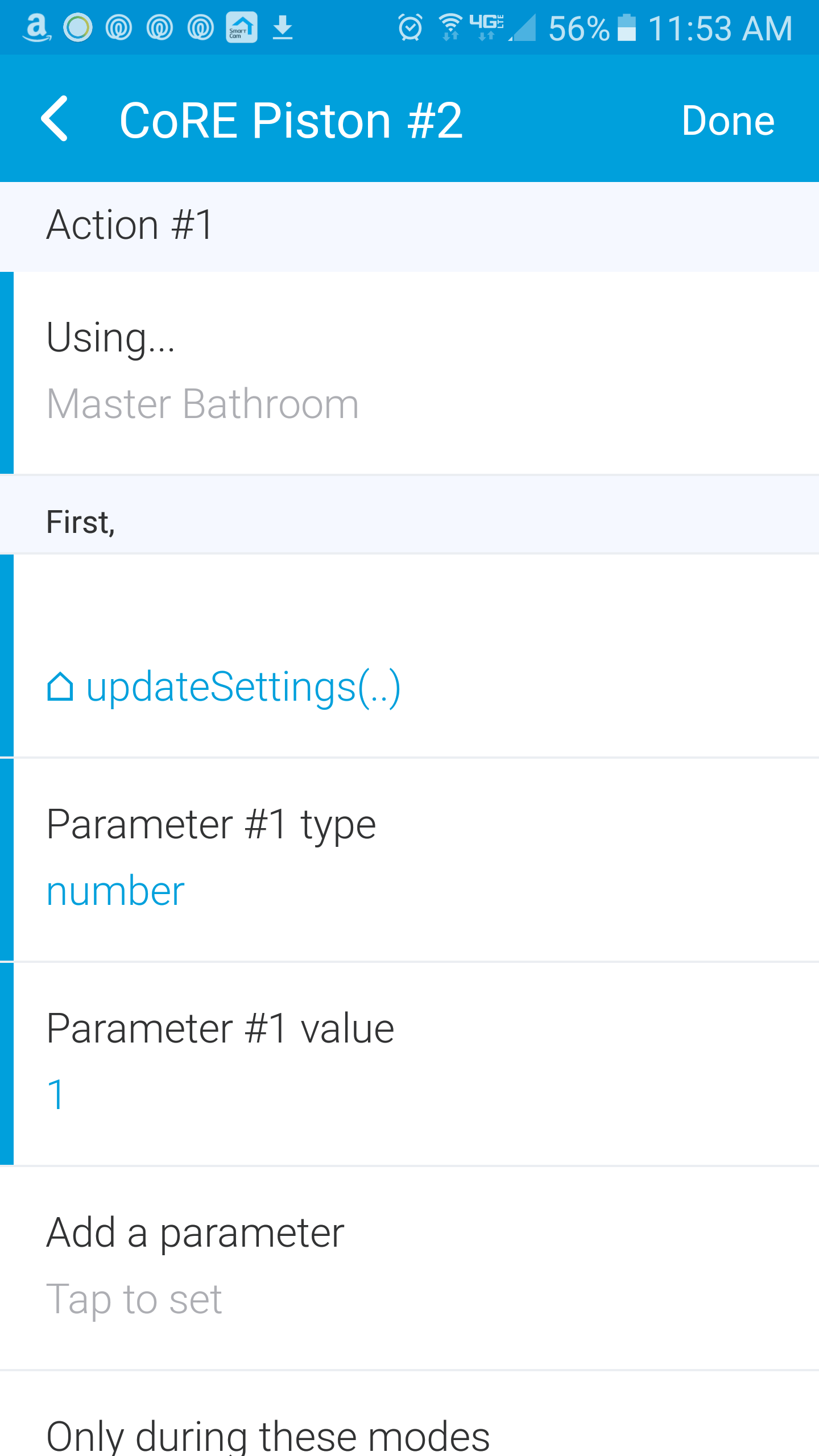

Is there any way to get CoRe to change the dim rate parameters for a GE dimmer?
I am using this DHT https://community.smartthings.com/t/modify-ramp-rate-on-ge-jasco-dimmers/
I see a task in core named " updateSetting(…) " however I do not see how to specify what parameter I want to set?

No, as far as I know the settings can not be changed via a smartapp.
