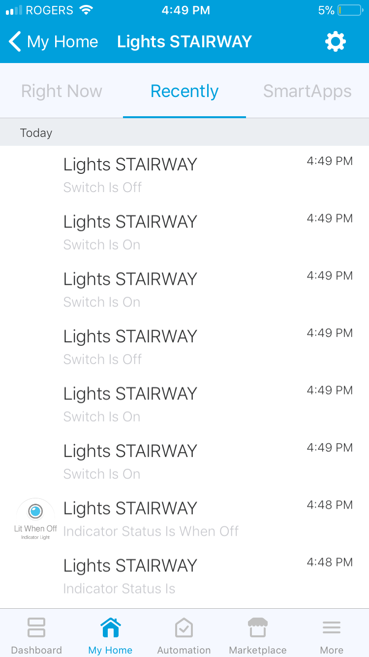

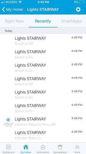

I like the changes, and thanks for getting to it so quickly, only thing now is I’m getting double reports when device is switched ON
I know this was an issue because these switches send 2 reports (physical and logical) for each on/off, so I removed one. I’m not seeing this behavior on mine though. Anyone else still seeing this?

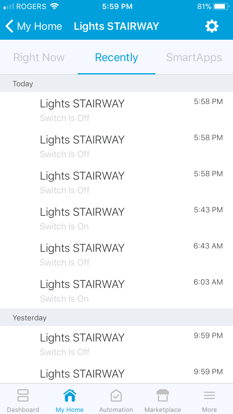

Thought it was better, until I just turned them off and saw this
