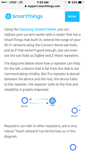

I’ve read recently that the Samsung Connect Homes now work as Z-Wave and Zigbee repeaters… Might solve your problem.
Repeaters are repeaters, and only for the one network they are on. It doesn’t change the total number of hops available. (4 for zwave, 15 into the hub for the zigbee protocol that SmartThings uses and 15 out again.)
