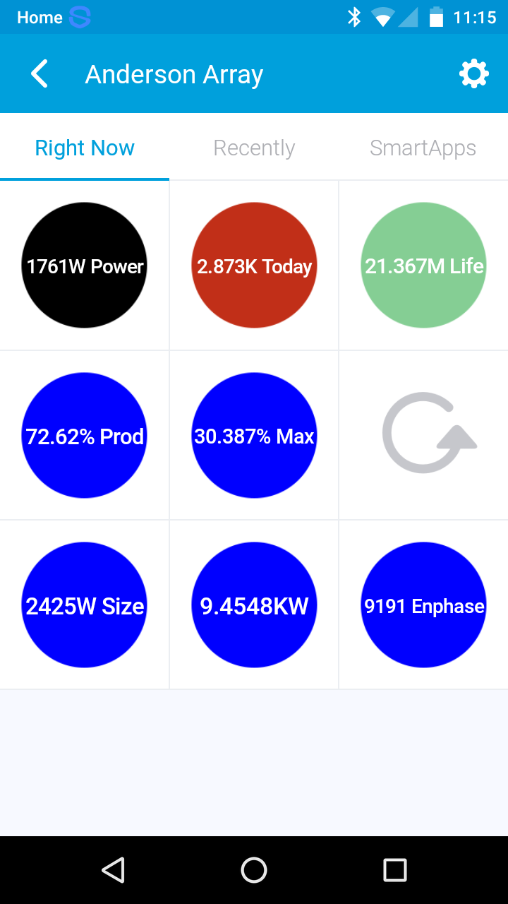

This is my first attempt at a Smartthings device driver. I used Ronald Gouldner
driver and modified it slightly to show a tile’s with Enphase estimated capacity and a percentage of the days power generated.
You will need to enter a value for each month. You can get that information by going to the Enphase Web site for your array. Under the settings page you will see a “Array Details” Click on that. Enphase provides a monthly capacity estimate based on Panel type and Age, Longitude, Latitude and other factors. Take the monthly value and divide that by the number of days in the month. This should give you a Daily estimate.
For example my monthly capacity for December is 293.1KWh, or 9.4548Kwh per day. for June’s its 472.9KWh or 15.7633KWh per day.
This is screenshot. Of the 2.873KWh generated so far today it is 30.387% of the Enphase estimated 9.4548 KWh for a day in December. And of the Array capacity of 2425W it is currently generating 1761W or at 72.62%.

Just saw it. And yes it does appear to be working. Not sure what the kWh/kw is telling me. It would probably make more sense after a full day.
Thanks Very nice this should prove useful.
OK I see its the efficiency. After the hail/squirrel repair my array is odd. Nine M190’s, two M250’s and 1 M215. 10 230W panels and two 265W panels. I will set it for 202W per inverter and 235w per panel.
Yes - it is efficiency and correlates to number of hours of maximum production (depending on where you live this typically averages somewhere between 4 and 5 over the whole year. The idea behind this calculation is that it allows you to compare systems of different sizes to each other.
This number is calculated using the panel size whereas peak production percentage uses the inverter sizes. With mixed arrays using the average value for each is the correct way to get those numbers as meaningful as possible.
