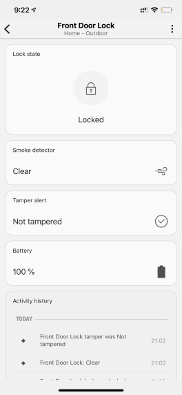

How come my Schlage Lock is showing up with a smoke detector in the new Smart Things application?
Very annoying that it says “Clear” instead of locked/unlocked in the app.
On the main page it’s status is also “Clear” so when you are scrolling through all the devices it does not say locked/unlocked.
Any way to get rid of the smoke detector “feature” for this lock?
Commenting the smoke detector capability should remove it, but I haven’t tested this personally.
It doesn’t. Maybe @RBoy has a recommendation or maybe even an update. Also would be fantastic if the tile reported “Locked” or “Unlocked” instead of the useless " Clear".
