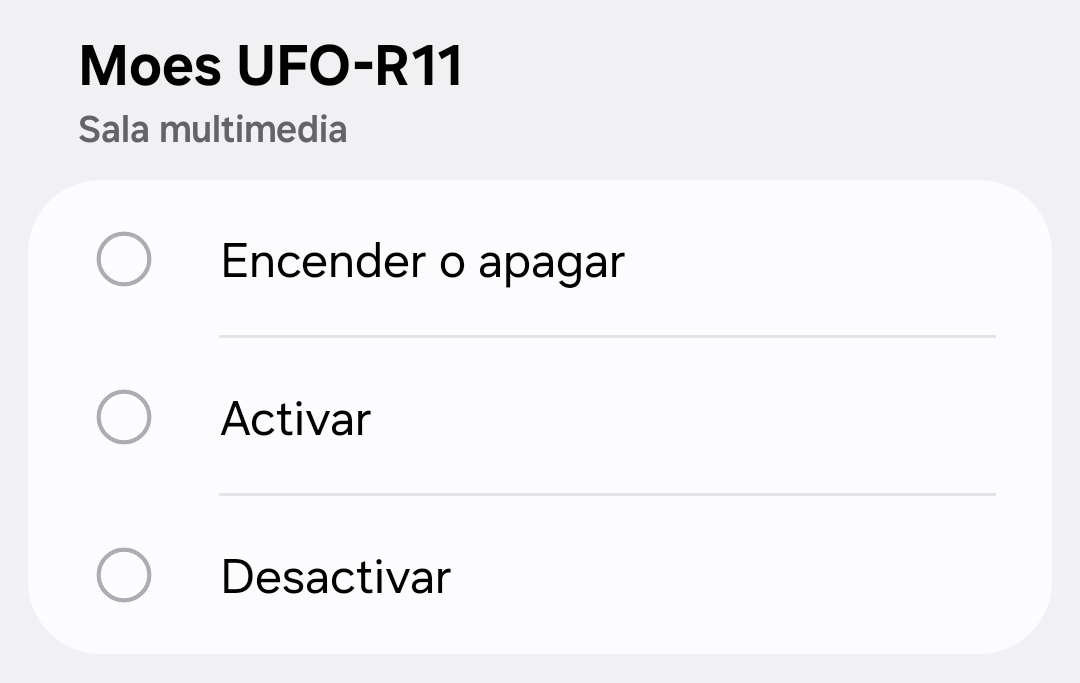

And third off, I’m not sure if this is a bug or not, but when I go to create a routine > Control Devices > IR Remote, if I select “turn on” I can specify a device from the driver’s devices list. However, if I select “Turn off” or “Turn on or off”, I cannot select a device from the devices list, the option to enable “Device selection” is grayed out and disabled. I think it’s “fine” for a lot of devices that do not have unique on/off codes, I can just use “Turn on” as a toggle. But for devices that do have unique on/off codes and a person wants to use them this could be a problem.

If you want to deactivate the switch in the routine that does not allow you to choose more commands, this is the normal operation of smartthings routines.
If you want to send commands in a routine without including the activate command you have to deselect “Activate” by clicking on it again. This is the normal operation of smartthings routines.

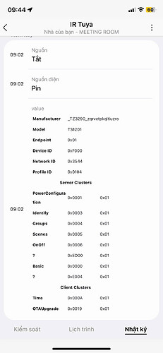

Hi Otivax, can you please add support for this device? Thanks!
Manufacturer _TZ3290_zqrvetpkqltiuzro
Model TS1201
Endpoint 0x01
Hi,
Fingerprint _TZ3290_zqrvetpkqltiuzro added

@Docga, you should check the power button of your routines. By default, On or Off action is set, and it might turn on or off your controlled device before performing the desired action. You should disable all the power on/off options.
