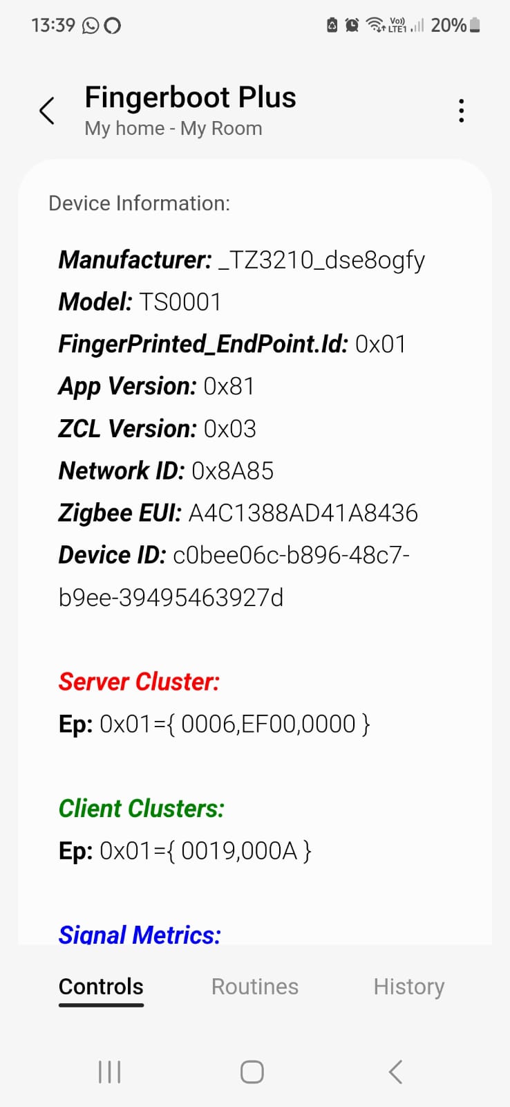

Ho acquistato un servomeccanismo Fingerbot plus zigbee, funziona bene con il tuo driver chiamato β€œzigbee switch MC”. Quando do il comando cambia il suo stato (OFF to ON) e poi torna alla posizione iniziale. L’unico inconveniente Γ¨ che nella app smartthings resta ON anche se Γ¨ tornato alla condizione iniziale di riposo. Se premo di nuovo da un nuovo impulso e anche nella app cambia stato (ON to OFF).
Ecco l’immagine, l’oggetto Γ¨ a riposo ma lo da come acceso
This device contain cluster EF00 which @Mariano_Colmenarejo drivers DO NOT handle.
@w35l3y deal with devices that use cluster EF00 , he also gave some instruction regarding add this device to his driver. Unfortunately I’m not a developer and therefore can’t implement those instructions.

All the DP (data points) are known…

The state that the app shows is the one that the device sends.
In order for it to work as a two-position switch, it must be configured using the EF00 cluster and at the moment I am not going to do anything with that.
You can pair it with a Tuya hub, they are very cheap, and set it up.

To use these DPs individually, you may pair the device in Generic mode and create child device to each DP you want.
Once configured, you may change the driver.
I didn’t add any button to the driver because I don’t know how they interact with the DPs.
If you have video/screenshots and logs (from smartthings-cli), I could add it.
