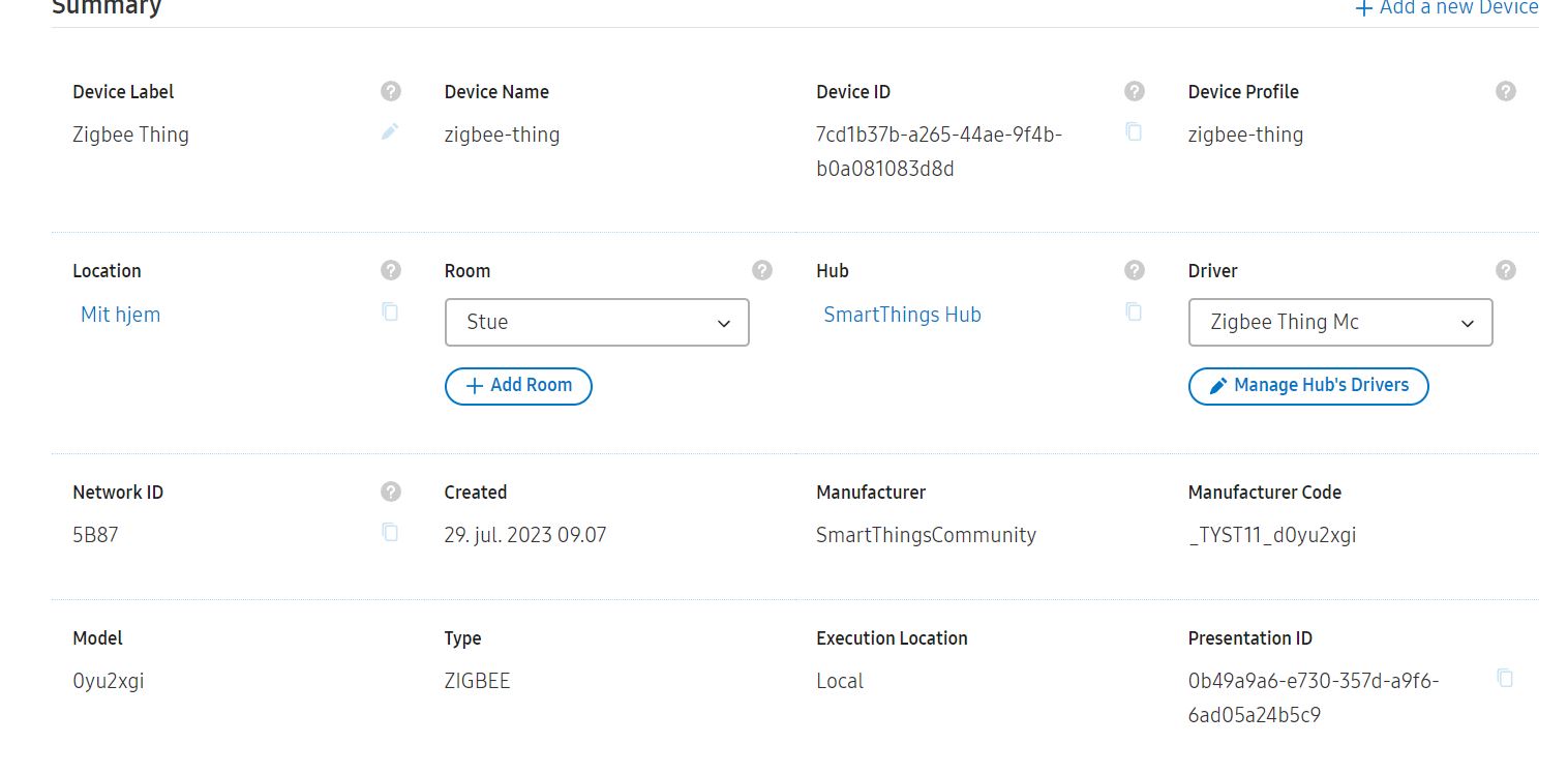

Hi Mariano.
once again thanyou for your answer.
I am new to this edge driver things.
But this i what i got from your Zigbee Thing Driver:
Hi @Pattayacity
Sorry, as @w35l3y said, the device doesn’t expose the EF00 cluster, but it does and it won’t work with my driver.
You have to use the driver that manages the EF00 cluster
